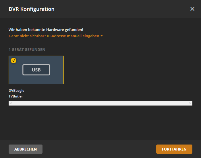

I recently purchased the TVButler TC100 and tried to get it up and running with my Plex Media Server (1.12.2.4929). The TVButler gets autodetected by PMS without any issues:
My problem now is that when I try to search for channels, non get found. I get the following warings within the Plex Tuner Service.log:
