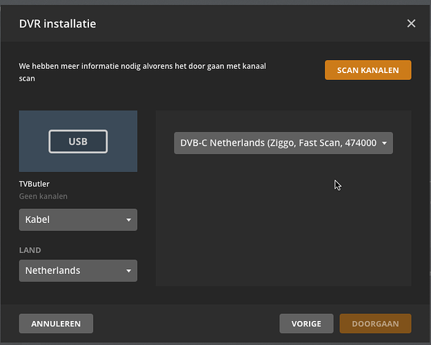

I like to use now Plex DVR together with the TVButler from DVBLogic. I’m very happy it is possible now but I have problem with found channels in the Netherlands. Plex find directly my tv butler so that goes very good. but now I want to find cable channels. The signal must be good because I have now also television with good signal with dvblink self so that is not the problem.
I need to use: Ziggo frequency 474000 this one is also in the list but when I scan the channels, it stays on 0% and found no channels, than I check all others in the list also 0%.
How comes this because at dvblink with exact the same ziggo frequency than the tvbutler found all channels with good signal.
Can anybody help me with this problem? (see also print screen)
With kind regards,
Johan
Are you sure that you first select Ziggo (474000) and then click SCAN CHANNELS after which it will pop up with the Network ID (4444 for FTA Ziggo) and then it will find all channels? Cause I just double checked it on my Windows 10 box with PMS 1.7.2 and WinTV Dual HD and TVButler both give me channels within a few seconds.
Also Make sure you select (CABLE) on the left :wink:
Hi Michiel,
I don’t get the pop up with Network ID (4444 for FTA Ziggo): See print screen when I click now on scan channels I get after 5 sec the message with no channels found.
I have PMS 1.7.2 on the Mac mini
