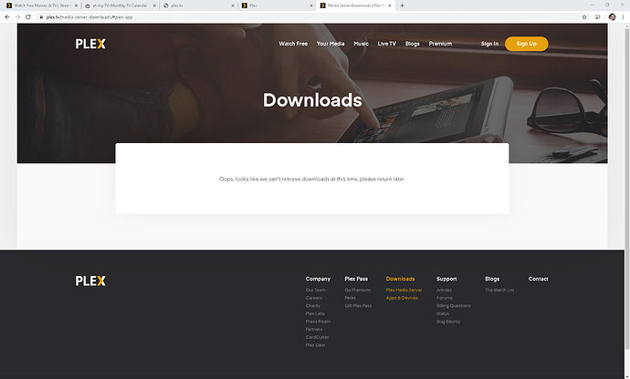

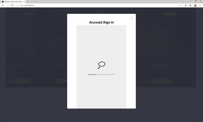

I am unable to login to plex from my server PC. I can login from a laptop connected wirelessly to the same network. At first I thought my account was hacked or something so I changed the password, but then I found that I could not get to the login pages from my server and now I’ve left my server unclaimed. I’ve checked my IP settings and made sure they are the same as the laptop on the same network that can connect. I tried multiple browsers and incognito mode. I restarted my server and my modem. I changed my DNS assignments around. I tested HTTPS sites and I can get to every other one I’ve tried. I can’t login to plex or the plex forums from that computer.

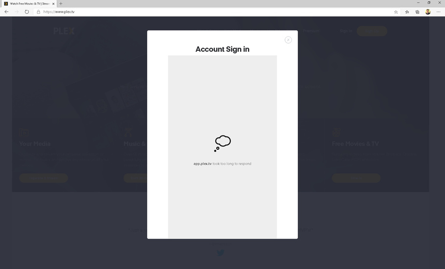

As I said, I tried three different browsers and incognito mode as well as clearing and disabling everything. I included screenshots.
Just tried booting into safe mode as well (took some effort since it is normally headless) and any element that tries to load app.plex.tv fails to load. I tried a VPN too wondering if my IP got blacklisted or something, no change.
