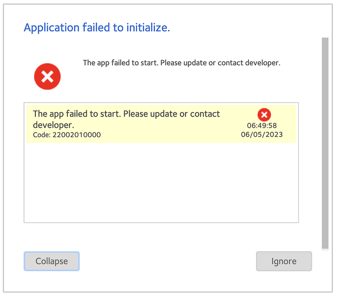

I have been happily running Plex Media Server from my ReadyNAS RN214 for a year or so but suddenly the Plex server app will not initialise at all. I have reinstalled it a couple of times. Each time i first launch in a web page it i get error ERR_CONNECTION_REFUSED
After this first time i try and launch the app, it turns itself off within the ReadyNAS GUI and then refuses to turn back on again giving the following message:
“Application failed to Initialize. Please update or contact developer.”

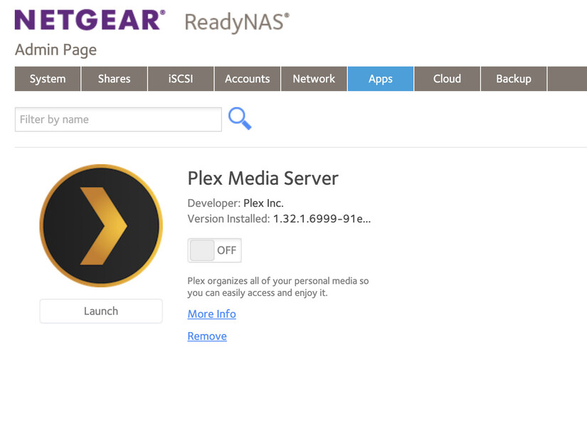

UPDATE 15th April 2023 - Plex app will also not uninstall (Remove). Tried multiple time to remove Plex app but still appears on the Installed Apps page but remains turned off. Reinstalling plex app also makes no difference. It seems that Plex support is a bit non-existent on this issue as seen on other post with the same issue.
ReadyNAS Firmware 6.10.8
Plex v 1.32.0.6918-6f393eda1 - April 6, 2023

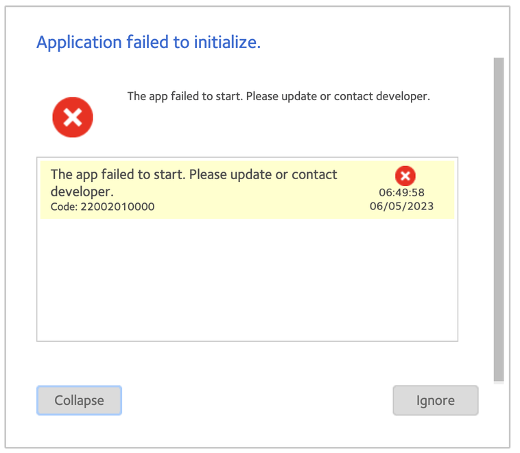

Similar issue for me. Over the past few days the Plex server app on my Netgear readynas 3138 just turns itself off for no reason.
Whenever I try to turn it back on, I get the following message - see screenshot.

My Netgear NAS just simply refuses to turn Plex server on. I keep getting error code shown in the screen shot.
After updating to the the latest beta version of the server and restarting my NAS, I am now able to turn on the Plex server and it stays on… so far so good.
