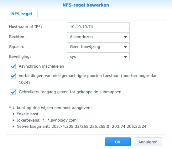

I had unmounted the shares, stopped the plex service and removed the plex user from the shares on my Synology. Restarted the Synology, recreated the plex user and gave read only rights on the shares.
Then I told the NFS setting in the shares to allow read only traffic from the servers IP.

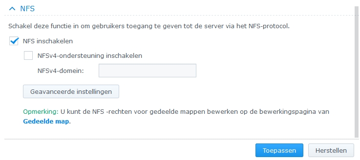

Concerning the settings for NFS on the Synology, should I enable v4?
And on the NFS settings per share, besides the read only, should I change some other settings too (squash,…)?
nfs

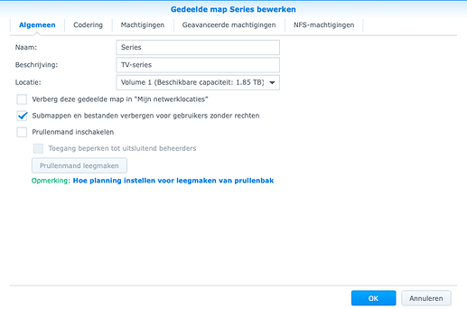

After some time I noticed the following differences in the screens. This is what I see for the Films share:
This is the same screen but then for the Movies share and the Series share:
As you can see, the bottom part of the window is missing for the Films share. There are no “Advanced permissions for shared folder” settings.
I think it has something to do with this. Does anybody know anything more?

This is what I get when I do “sudo cat /etc/exports” on the Synology:
/volume1/Films	10.10.10.74(ro,async,no_wdelay,no_root_squash,insecure_locks,sec=sys,anonuid=1025,anongid=100)
/volume1/Movies	10.10.10.74(ro,async,no_wdelay,no_root_squash,insecure_locks,sec=sys,anonuid=1025,anongid=100)
/volume1/Series	10.10.10.74(ro,async,no_wdelay,no_root_squash,insecure_locks,sec=sys,anonuid=1025,anongid=100)
I really don’t know what to do here.
Create a username plex on the Synology.
Give username plex permission to read the share(s).
(Control Panel - Shared Folders - share-name - EDIT - Permissions)
This is the easiest way.
Next, be certain to allow ports higher in the NFS export rule
Attempting to force the Synology will only lead to frustration if these steps have not been performed first.

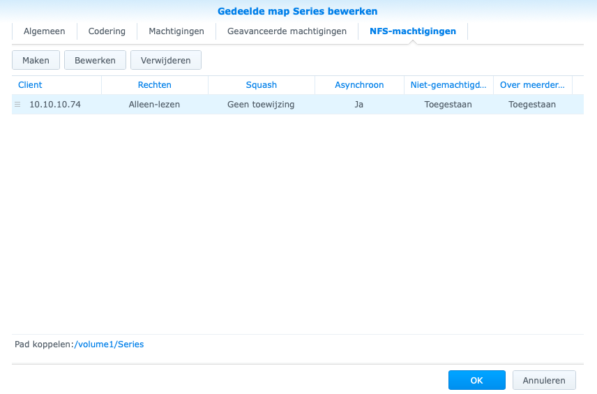

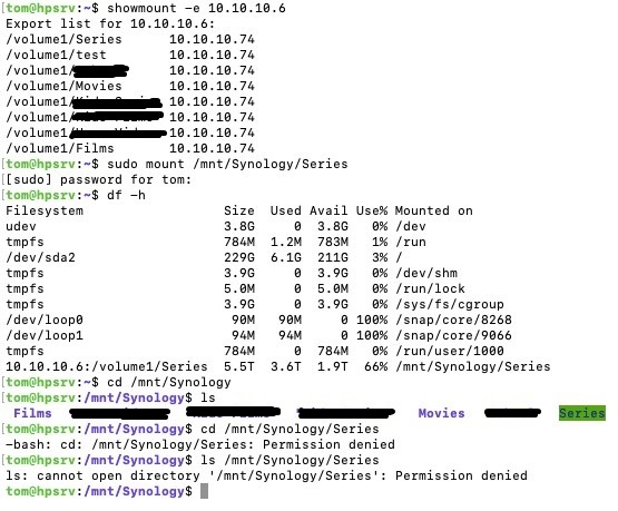

EDIT: I tested what you posted but still I can’t cd or ls the shares. They are mounted but that’s all.
Here are my settings on Synology:
3
When connected per SSH and trying to cd or ls:
4
You do not need to restart DSM after making the changes. The exports list is regenerated.
On my LAN, because all machines are mine, I use the wildcard * host IP specification.
It makes life easier. “Set & Forget”

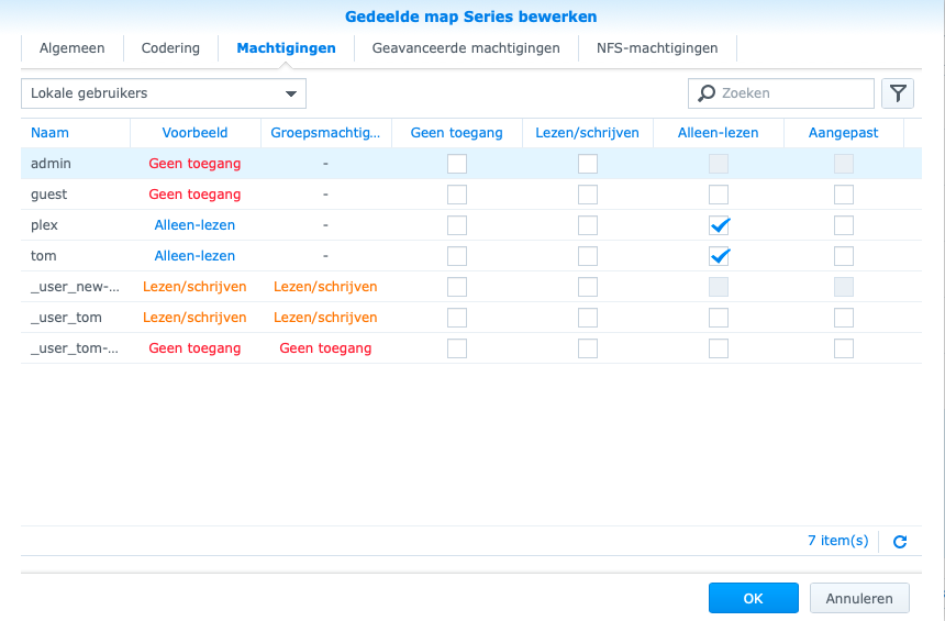

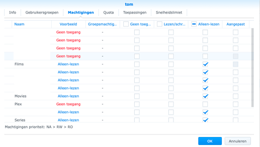

Both accounts (tom and plex) are enabled, both have no password (although dots are shown) and both have the same settings.
Here are the settings of the user tom. I have a plex share but that’s from the previous plex install on the Synology.
Here are the settings of the Series share, one of those that’s not working:

Ok, I think I found out what’s wrong and a possible solution.
So at the time I bought the Synology NAS, I read on the Synology knowledge base that it’s better to disable the default admin account and also the guest account, which I did.
Today, I connected to the Synology over ssh and using the sudo cat /etc/exports command I looked up the nfs specifics for the shares. I found out that the anonuid and anongid were 1025 and 100 for all shares.
With the sudo cat /etc/passwd command I searched to which user these uid and gid belong to:
guest:x:1025:100:Guest:/nonexist:/sbin/nologin
At that moment I reminded that the guest account was disabled because of the Synology knowledge base. As a test I re-enabled the guest account and gave it read only permissions on one of the shares. Then I changed the NFS settings to all_squash (map all users to guest).
When I now mount this share on the client, I no longer have “permission denied” error messages. I can perfectly cd and ls the files.
I thought that “map all users to guest” meant to “a guest”, I didn’t know it meant the guest account on the Synology.
Knowing all this, is it possible to map the users not to guest but to a specific user that I created? Or is that not possible?
Also: because of some update in the past, at a certain point ACL was put standard on the system by Synology. I suppose that because only the Films share already existed back then, the ACL permissions were not forced upon this share. Maybe that’s why I could connect to the Films share but not the other ones which were created later with ACL permissions.
You can’t force the username/group like you can with CIFS but you have something even better.
NFS supports sec=sys which turns off NFS’s authentication mechanism. sec=sys means that each host will perform its own security checking and NFS will defer to the baseline Linux UID/GID permissions bits.

I changed nothing but when I want to see the files in the shares I get this message:
ls: reading directory '.': Permission denied
Yesterday I saw a list of the files.
