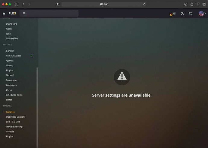

Plex Media Server completely crashes no matter how many times it's restarted
Server Version#: 1.24.0 and 1.24.1 (it started happening in 1.24.1 and I rolled back, still happening)
Player Version#: Latest versions on MacOSX, AppleTV, iOS, and Android
So Plex Media Server has essentially just collapsed on me. No matter how many times I attempt to update it or reinstall it, it’ll boot up, I’ll be unable to scan, unable to edit libraries, and unable to play anything. I can open Plex app on other devices and see my media but be unable to play anything.
And after about 15-20 ish minutes (sometimes more) it becomes completely unresponsive and I can’t even open settings in web anymore at all. I’ve tried multiple versions of Plex Media Server. It’s been working fine for over a year and in the past 18 hours or so just nothing.
I’ll attach my latest logs here and can reply with any questions…I’m very desperate and don’t want to lose everything especially after paying for a lifetime pass,
Also this happens a lot:
Full logs: Plex Media Server Logs_2021-08-25_13-14-50.zip (1.5 MB)
