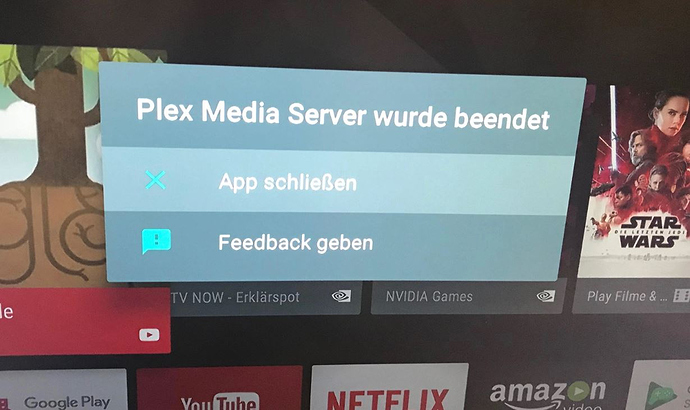

German Screenshot : Plex Media Server get closed / Close app / give feedback

What error message popped up At 17:33:09 ? Any screenshot ?
The same like in the initial post.
That Plex Media Server app crash message.
But the Server is running after this message fine (Web Interface is working / Plex client can access the server ), maybe the server restart after that message or is still running and the Android Error Message is wrong.

So it is actually running despite the pop-up. Does the signal 0 correspond to time when the pop up is acknowledged ?
Could you select the Give Feedback button - that may send a crash report in.
I suspect the Kill 0 is when you select App schließen (Close App)
