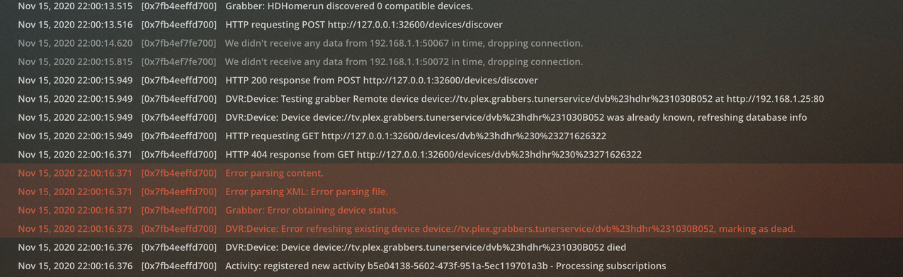

Looks like the media player finds the HDHR, but can’t add it for some reason.

Did you try to completely delete and reinstall the DVR?
Yes. This is actually after I have deleted the DVR and am attempting to re-add.
Do the channels play using the SiliconDust app separately?
Yes, everything but plex.
The only other thing I could suggest is to try a new Ethernet switch and, or cable.
Thanks for the suggestions. I installed plex on a windows pc, switched the cord to it (behind same router, same cord), Plex on Windows finds the hdhomerun, the linux box struggles with it.
Just going to live with two servers for now…
