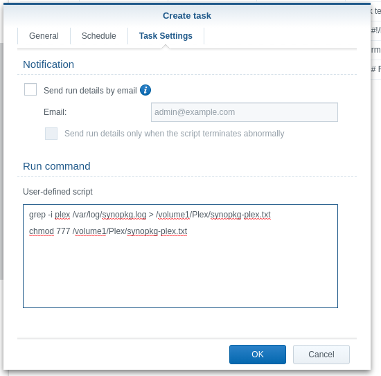

let’s do it this way please.
  1. Create a scheduled task of type user-script
  2. paste these two commands in it and run the script once
  3. The output will be in your Plex share (volume1).
  4. Compress the file (right-click it)
  5. Attach that file here with your reply.
The commands
grep -i plex /var/log/synopkg.log > /volume1/Plex/synopkg-plex.txt
chmod 777 /volume1/Plex/synopkg-plex.txt
It will look like
Screenshot from 2020-09-05 21-59-47
After we’re done, you can delete the files.
