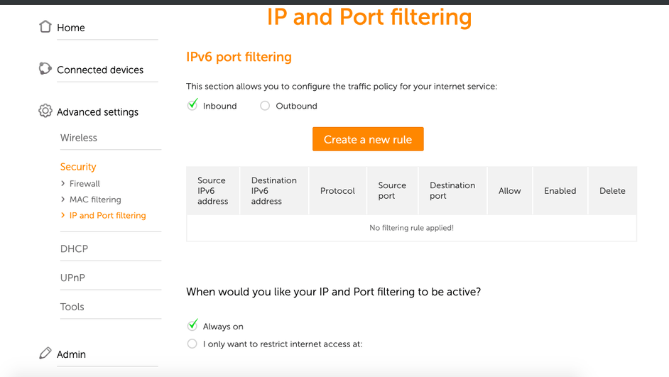

When I take a look in my modem/router settings, I can see the modem is giving my laptop a IPv4 adres and not an IPv6 adres. If i’m looking to the IP/Portforwarding section I see this:

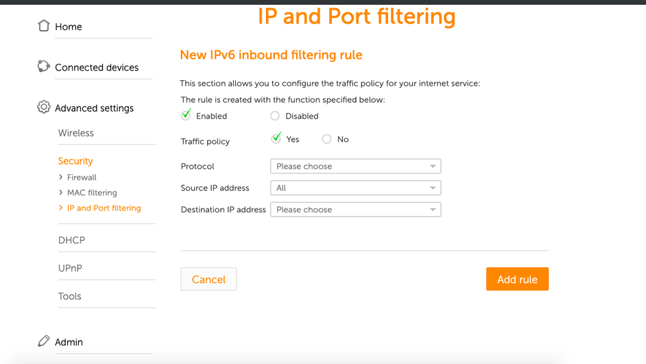

When I press ‘create rule’ I see this.
And that is where it stops for me, because I cannot find a setting that I need.
And I cannot find a correct guide for this. Even from my provider…
Do you guys know what to do? Thank you in advance.
