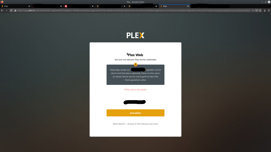

Hi guys,
i have been trying for some time to register a plex media server installed on a raspberry pi with my plex account. But whenever I am soerit comes first: successfully registered, and after a few redirects: Error during registration.

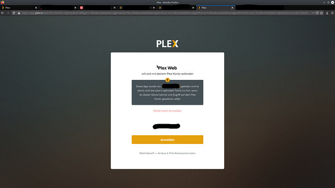

The screenshot you show should have the IP address and info of your server.
It does this the first time (cookie challenge) to make sure you ended up where you expected to. It’s an anti-phishing / anti-redirect check for you to be certain. There were cases were folks would think they are going to a a friend’s server and ended up somewhere else.

its absolutly right, it was my way. its navigate automatigely to this page
