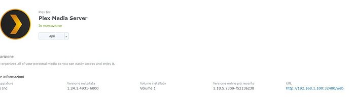

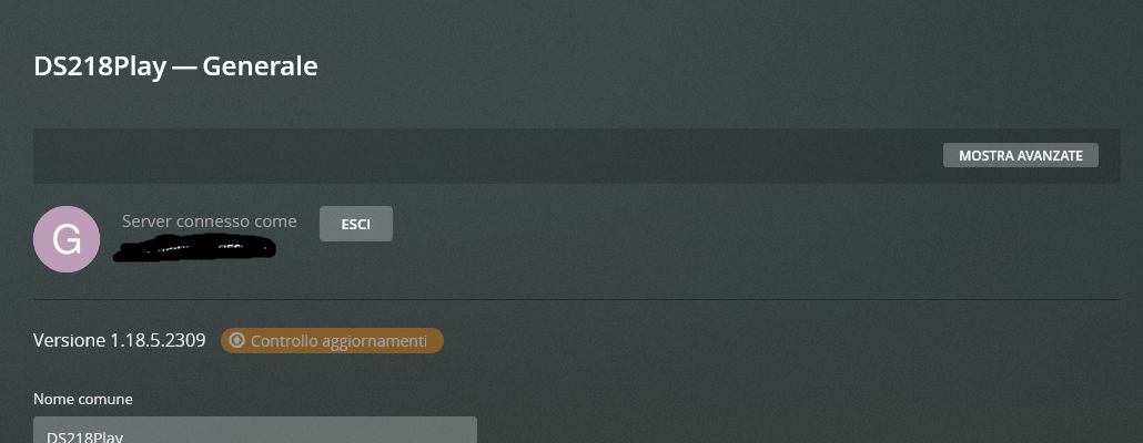

still don’t understand why PMS says I have version 1.18.5.2309 while my Nas says I have the newer 1.24.1.xxxx …
Can you elaborate where exactly you see which version? Maybe a Screenshot or two.
Plex Web > Settings > Server > General?
Compared to package center ‘installed version’?
I never had the plex settings showing an older version. Only discrepancy always was the ‘available version’ in the package center.
here they are:
“versione installata=installed version” “versione online piu’ recente=more recent online version”
Interesting. Never had that.
Guess something went wrong on the uninstall/reinstall mixer.
Not sure if this version display comes out of the preferences.xml of plex or if there are others sources.
But makes you wonder if there might be other older parts of the installation not being replaced with new code as well.
