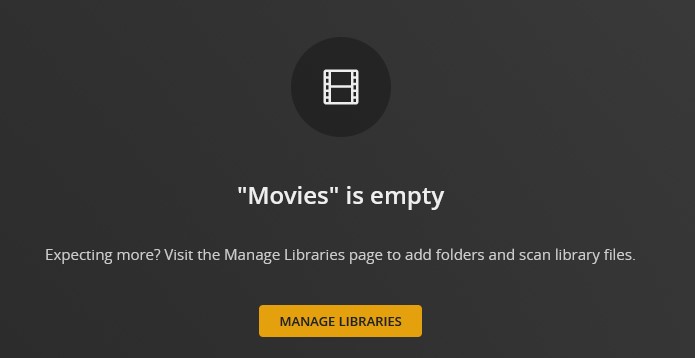

Not sure what to do now. Should I manually create the user? Right now it does not recognize my libraries. Even when I manually add a library it displays it as being empty (see attachment).
Any help would be, helpful!
Sorry I made a mistake, it did create the user but did not recognize my previous libraries. Even after I granted permission to the PlexMediaServer user.
If you did everything correctly.
  1. The Plex shared folder is EMPTY, except for ‘Migration.log’
  2. All your library sections are carried forward to DSM 7.
It you still have Library/Application Support/Plex Media Server in the Plex shared folder – IT DID NOT MIGRATE.
Show me the contents of Plex/Migration.log please ?
It did not migrate. No big deal. I am manually creating the libraries, I only had 5 of them and PMS is now working on my Roku and Pixel phone. So I am happy. BTW there was no Plex/Migration.log. Thanks for your help.
