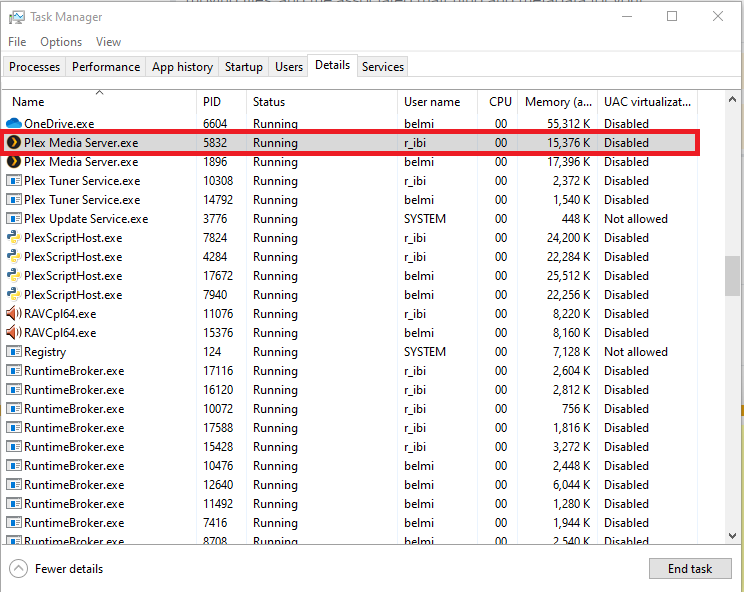

I have two accounts on my Windows 10 PC. On account A I have the server installed. If I log to account B, and shut down my PC from it, when you turn on the PC next time you will be prompted to log in again to account B (the last one used). At that point, if I switch to account A and log in, the server becomes inaccessible. I have to restart PC from account A so that it defaults me to it on the next login in order to get the server available again. So the server becomes accessible only if the LAST logged in account was the one which installed the server and was the one that turned off the PC.
In task manager it shows Plex Media Server run twice, the one in the red square is from the account B. If I end any of these servers, it doesn’t help. Running server again doesn’t make it available, even the web interface becomes unreachable.
This was happening for a long time, so it doesn’t affect only this version, many previous versions have the same issue.
The Plex server runs in the “user” context. Which means that the registry settings, as well as any and all data in the Plex data folder is only available to this user.
As a result, if you start Plex server under a new user account, it will behave as if it were never installed on this computer. Because it doesn’t have access to the data in the other Windows user account.
Additionally, if both Windows user accounts are logged in, Plex server might be running twice, as demonstrated by the above screenshot. Look at the column “User Name”.
