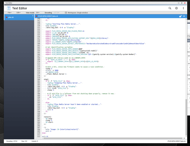

Would it be possible, for the Linux noobs, to provide a little more detail as to how to create a .sh file. Location of said plex.sh and how to create flag file? Myself I am 90% comfortable, but would sure be nice for everyone to get set of instructions.
@mncasper78
I’ve considered it but the amount of bullet-proofing in written instructions would be an impossible task. It’s impossible because too many folks use Windows on their computer. When you copy/paste with Windows from the web into a file, Windows will always add CR & LF as the end-of-line marker. Linux uses LF as the end-of-line marker. This results in CR (carriage returns) on every line and breaks the script. The shell interpreter doesn’t know what to do with them.
The best I can offer is repackaging the existing released packages and sharing them here in UNSIGNED form. If I do this, I can be guaranteed Windows will respect the QPKG as the binary file it is. The new version of plex.sh will get dropped in exactly as it should be by the QDK routines.
Should I repackage and post temporary links ?
Sounds like the more reliable approach. Unfortunately just puts more burden on you to create the packages. Myself running on QNAP and my first attempt at create .sh, making executable and creating flag file did not work. Plex did not load, but I am guessing it is my plex.sh file and CR.

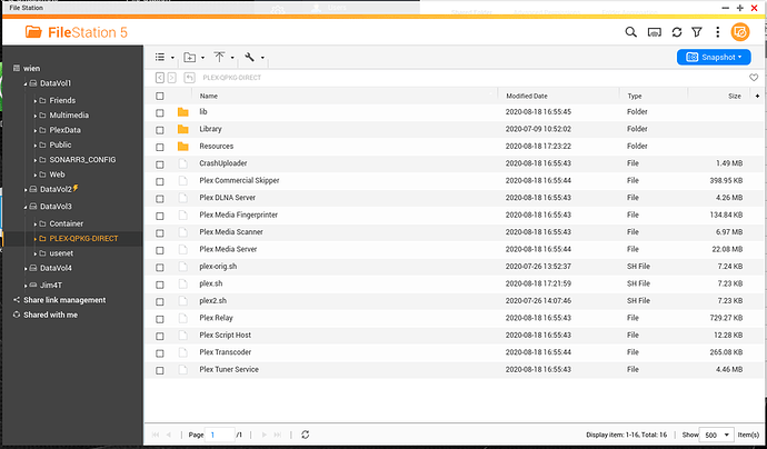

Where is your PMS installed? CACHEDEV1_DATA ?
Let me know and I’ll give you the steps. You can try it and see what you think.
/share/CACHEDEV1_DATA/.qpkg/PlexMediaServer. Created the flag file with touch command.

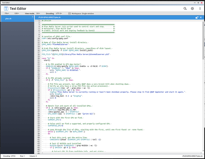

NON-OFFICIAL QPKG MODIFICATION TECHNIQUE.
(note: This example shows CACHEDEV3_DATA. Most systems are installed on CACHEDEV1_DATA. Please use the correct location for your system)
  1. Install QNAP Text Editor app (App Center)
  2. Create a share, manually specifying the location of where Plex is installed on your system. This example is on CACHEDEV3_DATA. Most systems will be CACHEDEV1_DATA. Please adjust accordingly
  3. Install the QNAP Text Editor app in App Center
  4. Open File Station. Migrate into this new special purpose share to expose the raw Plex package files which are normally hidden.
  5. Make certain PMS is STOPPED
  6. Right-click plex.shOpen with Text Editor
    6a. Observe it looks like this:
THIS IS WHERE IT GETS TRICKY – BE CAREFUL
  1. Scroll up in this thread to get the updated plex.sh I posted
  2. Highlight all the text in that window and right-click “Copy” (it’s usually easier to start highlighting from the bottom of the forum inset text window .. I don’t know why)
  3. Flip to the Text Editor window
  4. Staring with the first characters of line 1 #!/bin/sh highlight ALL the text (All 220+ lines)
  5. Right-click and PASTE what you copied from the forum on top of what exists.
  6. CONFIRM – 212 lines.
  7. Go to the upper left corner of the Text Editor: File → Save
  8. Exit from the text editor.
  9. Start Plex.
This is working for me .

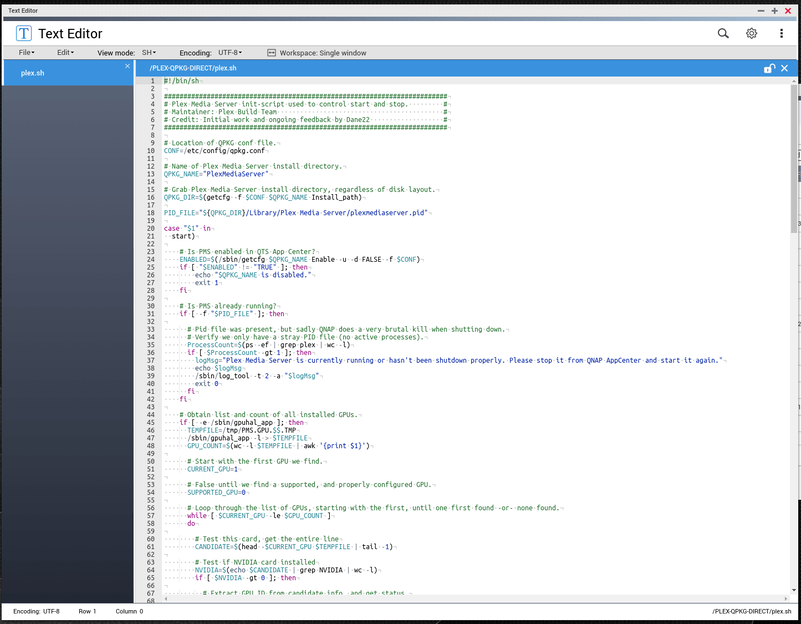

what’s the verdict?
Reviewed my work. Too late tonight. Missed the CR at the end of the new file after cut/paste. Kinda a big deal. Plex Starts/Stops normally now, but still cannot access Plex. I put in the original plex.sh and aside from the Share issue it runs. So it has something to do with the new plex.sh file. Either code or I am not doing something right. Created the new file with the Text Editor as you showed and with Notepad++ with correct EOL and chmod a+x on the new file. Feel like I am missing something simple.
Just to test. I copy/paste the original plex.sh script into a new file I created and saved, chmod, etc. Works fine so I am guessing it has something to do with the new code as file creation does not seem to be the hold up.
Late here too. Will deal with it tomorrow
It automatically works today! In reviewing the new working file and old unsuccessful plex.sh it appears with copying the code from the browser I was getting both CR and LF. The working script has just the LF. Kinda as you were mentioning above.
I assumed using the QNAP Text Editor from your instructions would remove the CR, but I was wrong as I can see them with using Notepad++.
As to why the current plex.sh on my system now has no CR thus making it work is unknown to me. Again just automatically happened over night.
I feel this is a noob issue on my side as I should know how to remove those CR when copy/paste.
This really isn’t a NOOB issue. Moving across disparate philosophies (CR/LF vs LF) requires a certain level of technical understanding.
To show you how CR/LF looks in Linux,
hello^M
there^M
The CR (which is Control-M key) looks like any normal character to Linux. It does see the LF and ends the line.
