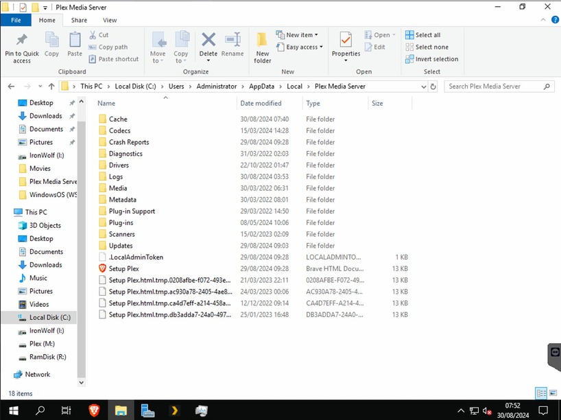

What I find interesting is I have the folder “Plex Media Server” in two locations and “Metadata” in another. Please see below…

Your first screenshot shows your current Plex data folder. (Which is not identical with the install location of the Plex executables.)

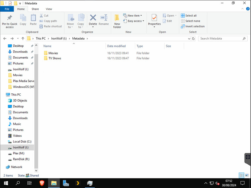

The second screenshot shows your actual media files.

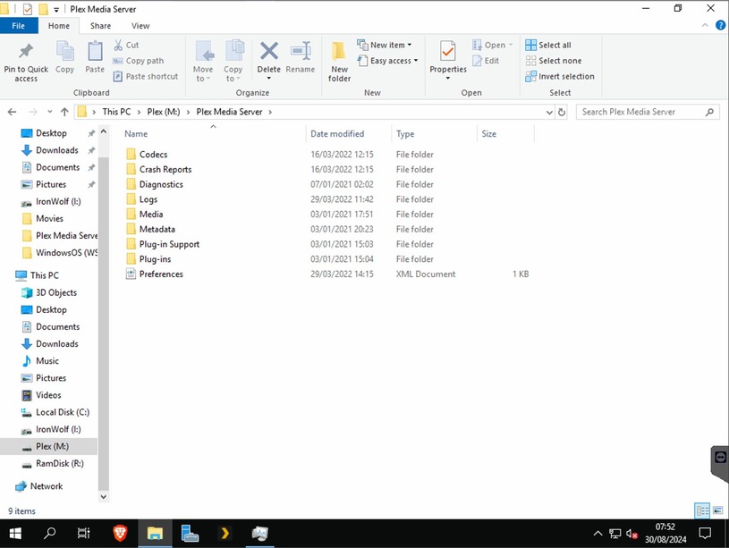

The third screenshot shows what is apparently an old Plex data folder, which hasn’t been in use since 2022.
That means your current Plex data folder is in the default location.

In your particular case, you should probably clear out drive M: completely, before performing the procedure described in the linked post.

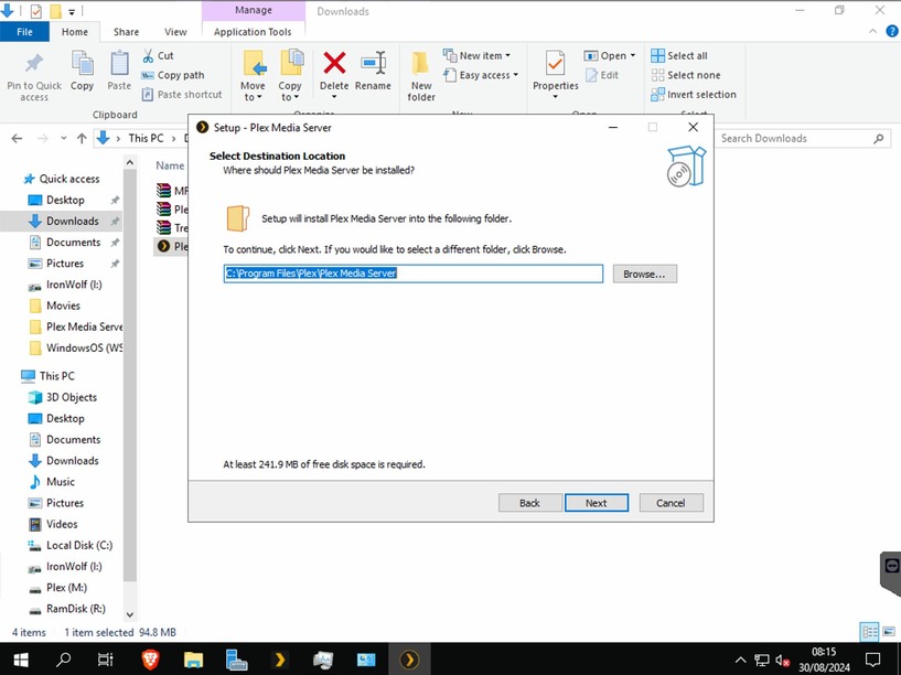

Alright. I’ll follow the advice that you first gave me. Just to confirm, this is the new installer I’ve just started. I leave this as is…
Correct.
