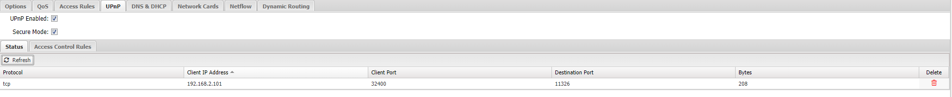

As what I thought might be an alternate test to see if my Plex Media Server can connect to plex.tv for remote access, I removed the manual port-forward in my Untangle Firewall. Then I turned on UPnP in the Firewall. I changed the config in Plex from specifying the port and letting UPnP set it up.
There’s a green check by the Remote Access in Plex again.
Then I went into my firewall and see that it dynamically created a port-forward. So my Plex Media Server appears to be able to reach plex.tv and set things up.
But I still get the error about being unable to connect securely.
