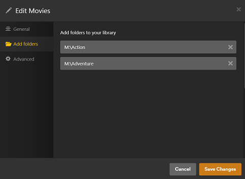

What did you actually add and remove? Folders to the drive or folders to your Plex library? If you added the folder to the Plex library then physically removed the folder off the drive but didn’t remove it form the Plex library, then those entries will stick around. Plex will not update a library if the library folder points to an empty/unavailable location. If this is the case, remove the folder from the library setting.
Like this. If any of these folders are empty/unavailable, the library will not update the contents from that folder.
As your picture shows this is where i added the folder. After I realized the mistake, I removed that folder from this same screen.
I never touched the actual folder on the actual drive on the PC.
Removing the folder from there should have worked. Do these videos have a trash can icon on them? If so you need to empty the trash. Otherwise something is wrong. Can you scan for updates then get me your logs.
