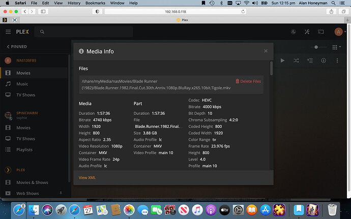

Can you verify (screenshots?) that your Plex Libraries point to the correct directories? And the movie files - the one that’s working, vs. an example that isn’t working?
I wonder if permissions were changed, or if something happened to rename a directory.
This is the one movie that Plex shows me and the screenshot shows that it points to the correct directory. As for showing one that doesn’t work, I’m not sure how I’d do that because there are no other choices.
I’m glad to see the “Movie Name (Year)” folder, that’s super helpful for matching.
How about outside Plex - if you browse to your nasMovies share itself, you have other “Movie Name (Year)” directories with movies inside them, equivalent to this one, I assume?
If so, my next thought is permissions - making sure that the user Plex is running as can access the files. Verifying that is going to be NAS-specific, and I don’t know the details.
It might also be useful to do a manual Scan Library Files in Plex, and then share the PMS logs.
This might be a good @ChuckPa thing, if he sees it. He’s a Plex-on-NAS wizard.
Ok, it’s at this point that I need to apologise for wasting your time. I’ve assumed that nasMovies had all the movies because Radarr shows them all but when I browse that folder, it only has two movies, the one that Plex says is in it’s library and another which for some reason Plex doesn’t show. Looking at Radarr, I now see that it thinks movies are located in an external drive that I used when re-installing Radarr.
So, now I need to work out how to change Radarr’s current folder to nasMovies and whether that means a mass import or something else. Nevertheless, once I get the movies into nasMovies, I assume I tell Plex to “scan library files” and it should then see them all.
Again, apologies.
The reason Plex doesn’t show the other movie is that the folder is empty!
