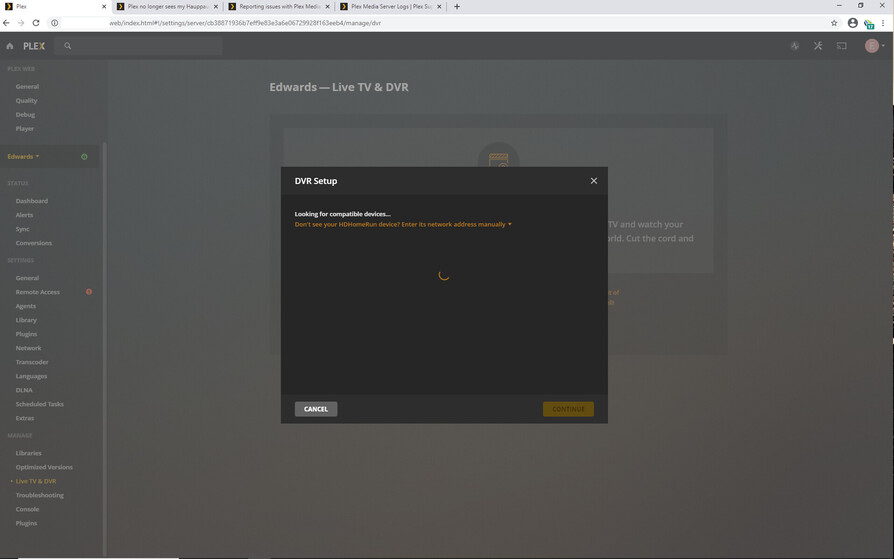

Plex no longer sees my Hauppauge WinTV-quadHD tuner, "Add Device" scans forever
Tuner service isn’t shutting down, it’s simply not finding my Quad HD tuner. WinTV still sees the tuner and works just fine but plex does not see it at all. I let it search for over an hour.

Yes winTV is shutdown and has since been removed when trying to add my Quad HD Tuners again. They use to work fine. I have included the logs and a screenshot of the tuner add screen.
I have also just uninstalled and deleted the drivers for the tuners, restarted, then reinstalled the driver and tuner.Plex Media Server Logs_2021-04-02_06-24-12.zip (1.2 MB)
