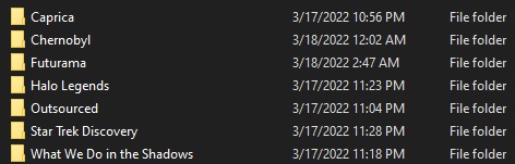

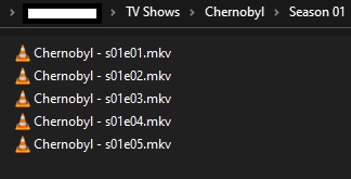

At this moment I have my TV series folder organized the following way (which I might add was working fine on the previous machines, and I do understand that there was a change)
tvshows1
tvshows2
tvshows3
and I even tried removing the episodes title, as well as lowering the case of the S and E (probably useless) I even tried reinstalling plex and accessing it via different broswers, to sync the shows.

I would like to add one more thing. I attempt to sync the shows everyday, in the hopes it will work, however, for example, let’s say I have Caprica synced when I try to add Outsourced, all Outsourced episodes are being added to the Caprica’s folder on plex.

Here’s your mistake… you only need to add the library folder (here: X:\TV Shows), not the folders of each individual show to your library!
It’s a rather common confusion. We’ve already asked Plex to „refine“ the wording on the Add Folder section to be more specific about what folder(s) to be added.
@nopunintended what tom said, Point your library to X:\TV Shows and it should work.

It worked, thank you so much for all your help and you as well dbirch, I did not think of doing that.
The problem is fixed, now I can continue adding more.
