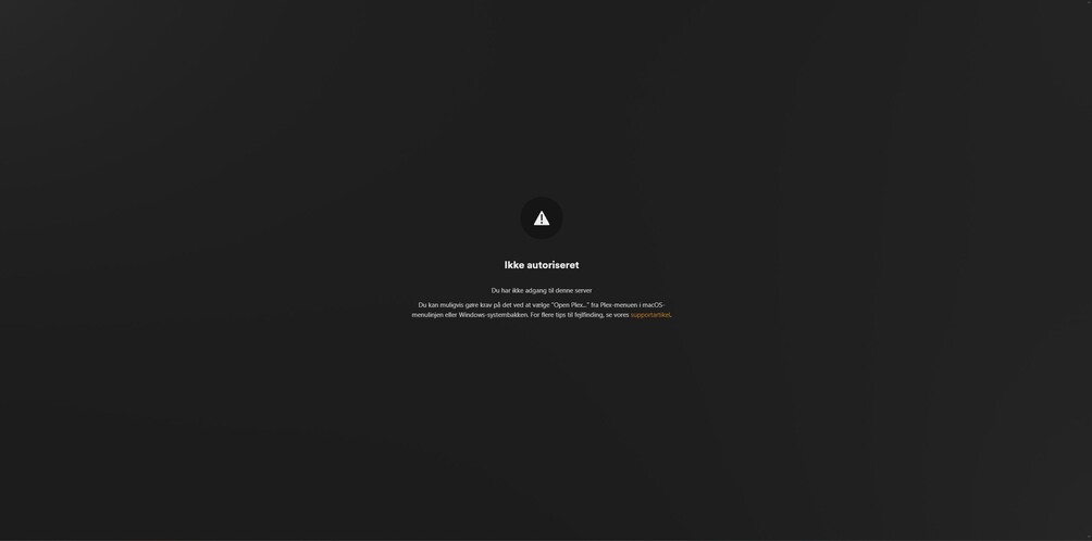

Trying to help a friends father that tried to Install Plex on his Synology DS216Play. He is getting some very weird behavior from Plex after the installation. He is getting a Not Authorized message that tells him he can possibly claim it:
But there is no way to access Settings to claim the server and looking at the Support article linked it talks about removing some lines from the Preferences.xml, but these lines are not in the current xml:
