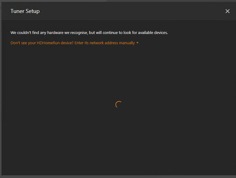

But when I’m in the tuner setup window its just hanging on this

I’m having the exact same issue. My Plex setup has been running great for years on my NAS but one of the recent updates caused the OTA TV tuner to stop working. When I removed it from the interface as part of troubleshooting, I get the below error when I attempt to re-add
My HDHomerun Extend TV tuner is fine and reachable from every other scenario I could test (PC browser, VLC on a phone, TV app, etc) I attempted the listed troubleshooting around restarting, shutting down and deleting the media_provider_resources entry using DB Browser and confirmed the entry is gone but there appears to still be references. You can see in the screen cap even with the entry deleted my Plex instance is still looking for an old reference. Interestingly if I setup a clean test instance of Plex I can get the HDHomerun to show up immediately no problem so this does appear to be something about the upgrade process, possibly for long-running installs.
