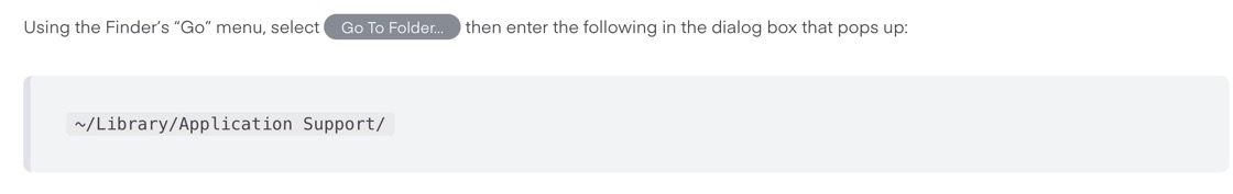

The Tilde ~ refers to the Home Directory
Now days this Library is hidden but if you hold down Option Key it will appear in the Go Menu, Navigate to the files your looking for within this Directory.
So plex stores its data in ~/Library/Application Support/Plex Media Server/ on macOS. The database files are located at Plug-in Support\Databases and your log folder is Logs.

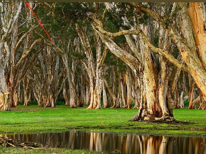

Can you take a screenshot of where your looking , please.

Wrong Library, that is not the Home Directory. Must use the Go menu top of Desktop
Ok and what do I type in on the Go to folder then?
Screenshot 2025-02-09 at 1.12.14 am
Click on attachment to Zoom

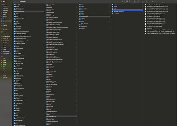

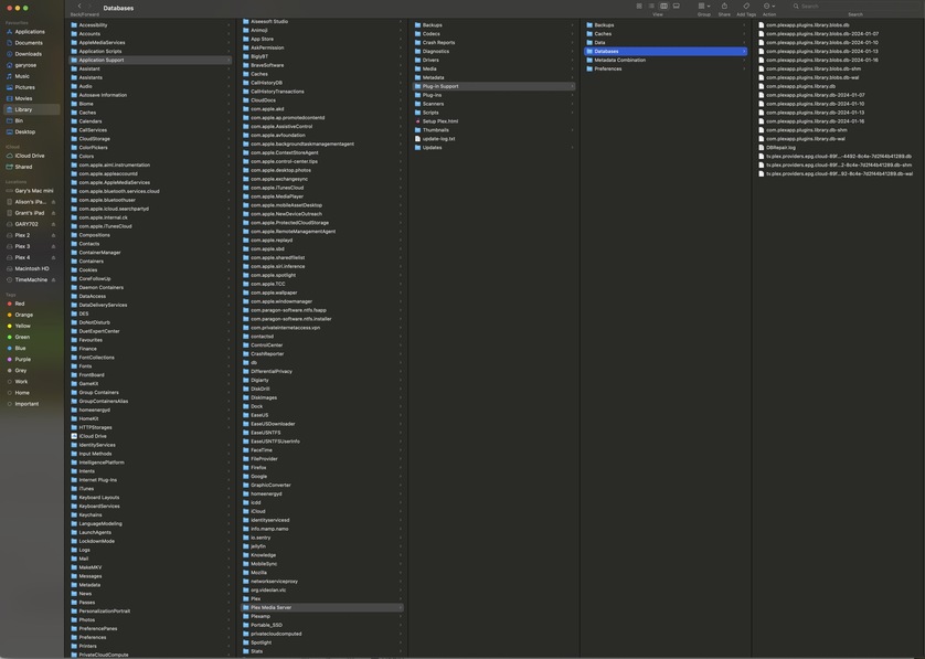

Ok perfect I have done that and filled that path. Here is a screenshot of the database folder.
What path in Scheduled Tasks Server Settings have you sent them
But I feel like it doesn’t run.
All the tick boxes are ticked
That is the full path? So it would have dumped them anywhere in Plex Media Server Folder but check Backups Folder
Hmmm. There are no loose files in Plex media server folder. And I do not have a Backups folder.
