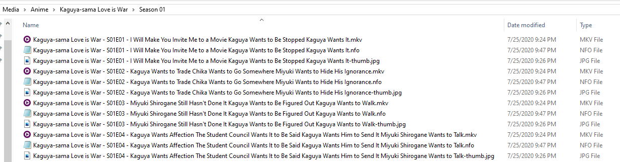

I’m having an issue with Plex where newly added shows (anime) to the library are not matched, causing the show to A) not fetch metadata from TVDB or B) use my local metadata. I use sonarr to manage my library itself, and take care to use FileBot and properly rename / organize the files in the way Plex/TVDB prefers, and this convention works across the rest of the library. A typical example is pictured below.

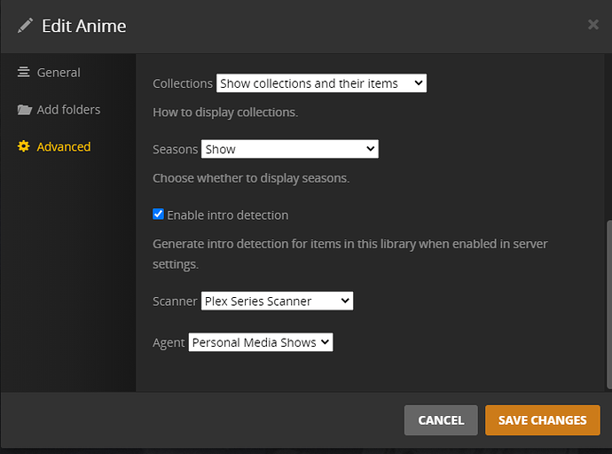

Since all of my metadata is fetched by Sonarr and stored locally, I use the Personal Media Agent to match series to metadata.
The agent is configured as follows:

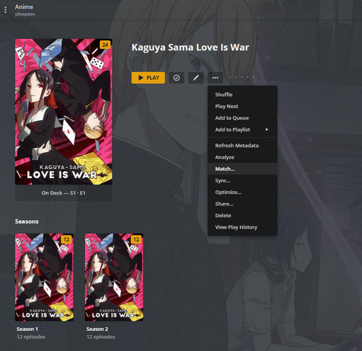

So revisiting the problem itself: the show appears on Plex as follows; no metadata populates. Since the “Match” option is available, it appears the show is not matched for some reason.

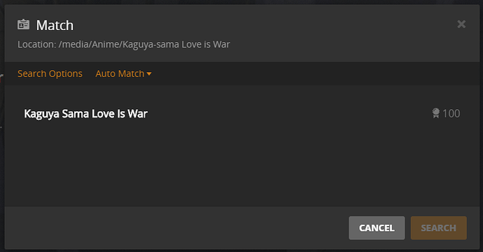

When I click in to match the show, an option to do so properly appears.
However, even after selection the option to match, metadata fails to populate, and the option to match the series remains.

Everything I’ve seen says Plex does not use .nfo files other than reading an IMDB id.
Local Media Assets reads embedded metadata from MP4 files only. It does not read metadata from MKV files.
Regarding artwork, think you need to remove -thumb from the file name. See Episode Artwork section:

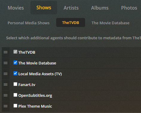

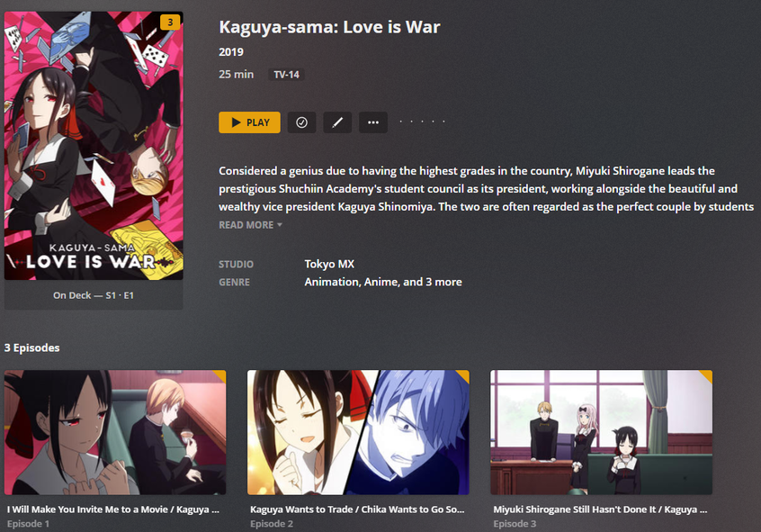

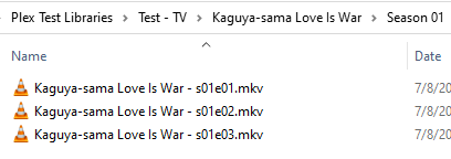

I had to manually match, but Plex did download metadata for the shows. I used TheTVDB agent, not personal media.
To match, I had to search for Kaguya-sama: Love is War, including the dash & colon, using the TheTVDB agent.
Match:
Files:
Agent Settings:
TV Library Settings:
Result:
