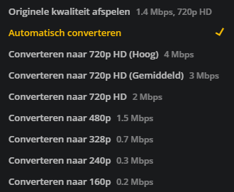

“Automatisch converteren” = Automatic conversion, wont work. Probably because of the original mkv file like you said. I will try another valid .mkv and report back.
Changing them to mp4 in this menu (see picture below) alows me to watch the movie after conversion. (sorry for the Dutch :stuck_out_tongue: )
Now, automatic conversion doesn’t work with a movie that does play in the browser. I have another movie as an mp4 which plays just fine in any conversion. But wont load anything on “automatic”
I’d say this is not that big of a deal, since I can watch the movie just fine. But I’m still worried that something is broken and thats why the automatic conversion won’t work.

None of the options of the screenshot below will load the video for me, sadly.

Ok. So the “Automatic Conversion” is the regular transcoding. In that example, the file has a bitrate of 1.4 Mbps, so pretty much any of those setting above 1.4 Mbps will cause the file to do the same thing which is just change from mkv to mp4. If the mkv is bad, this won’t work. Can you try a setting lower than 1.4 and see if that works. If so, it backsup the idea that the original file may have a problem.
The second “conversion” is the media optimizer. This writes out a new file, which is a little different from what it does to stream. This also backsup that the original is bad.

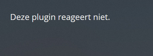

After installing some more plugins they are also encountering errors:
image (this plugin is not reacting)
