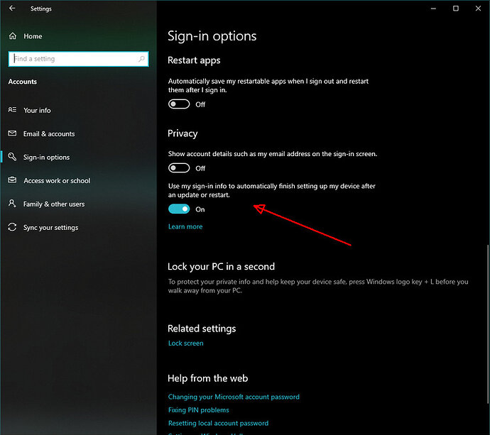

Just as another data point, I restarted my physical Windows-based Plex Media Server and did not log in. I’m still able to browse my libraries and play content. This is a single-user system, which does not use a Microsoft account (just a local one).
Since the last two or three Windows 10 builds, they silently log in the last Windows user account after system start.
All in an attempt, to make the system immediately available to the user if he eventually types in his password.
There is a registry setting to prevent this behavior (it might be an available “policy” as well)
DisableAutomaticRestartSignOn.zip (401 Bytes)
Great info, thanks.
this has been on windows insider previews for a long time, not sure if/when it was enabled for public release, but probably a while too.
you can enable/disable the auto-sign-in-after-update-reboot @
