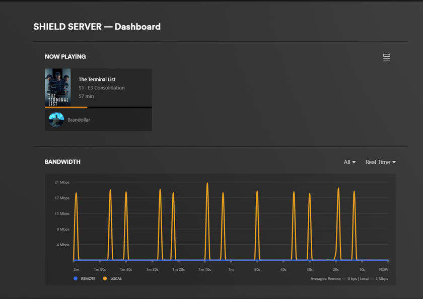

Thanks Tiebierius, tried those settings, no luck, see attached.
Graph looks concerning with the spikes and dips in local rather than consistent..

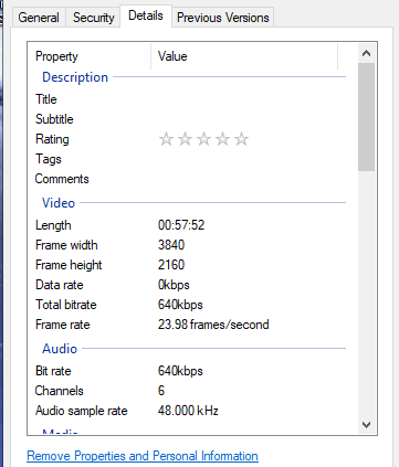

Wasn’t able to get the XML file, but screenshot details page of video file in case this helps at all.

Starting with the dashboard, the hamburger menu on the right side will expand the detail to give the media playback specifics. Any transcoding needs to be avoided.
Use the web app to get the xml by hovering over an item, 3 vertical dots in lower right. Get Info and View XML in the lower left box that pops up.
All this to say you are probably expecting a little too much out of the Nvidia Shield. You could reprocess your files so that playback is smoother. Stay away from 4K HEVC + HDR material especially if using subtitles. Shutting the Shield off or putting it to sleep creates a backlog in housekeeping tasks then when you restart it which will make things sluggish till it completes.
To be sure the file is in streaming format you could use the optimize feature to create a copy or run it through the Plex Transcoder “/path/to/PlexTranscoder -i YOURFILE.mkv -c copy OUTPUTFILE.MKV”.
Hi Tiebierius, xml info attached.

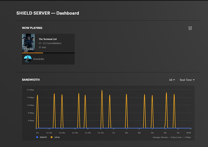

Does the graph i sent previously look a bit abnormal? It seems to spike up and down rather than a consistent line, maybe something else causing this?
