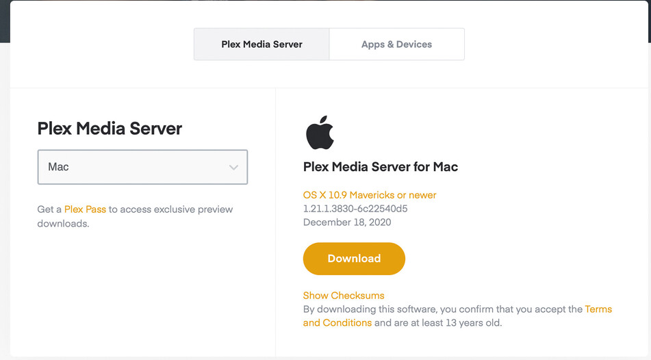

Once there I was shown this…
Which leads you, by it preselecting the sensed operating system, which in my case is the Mac. So I downloaded the preselected PMS on my Mac, followed the Plex app-led prompt on Shield to “Link” to the PMS. This led me down the path, and hours and hours of trouble-shooting and all your effort Trumpy81, which I believe could have been avoided, and I’ll explain how.

So what is very frustrating is that on the Plex download page, it does not mention to install PMS directly on the system that you want to use to access the media files, and choose that PMS. The only place anything like this was mentioned was on the DSM-installed PMS (the page I mentioned above). And I might never have seen this if I had simply uninstalled this instead of opening it.
An information window on the downloads page explaining which PMS you should choose and how the eco-system works would greatly help out new people, and avoid a lot of frustration.
