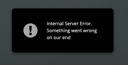

Been getting this message for a couple of days whenever I try to log into via https://app.plex.tv/desktop. Another topic was opened and marked resolved/fixed. But I have yet to see a fix. I’ve reinstalled Plex Server and can’t seem to get out of this loop, logging in, entering PIN, then blank screen with “Internal Server Error. Something went wrong on our end.”

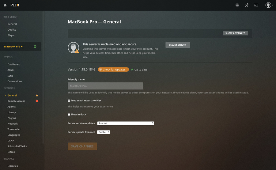

I will say that it seems tied to my Plex Pass account. If I log in using my wife’s credentials (on local or remote server), it seems to work. I’ve tried to claim server on my MacBook (http://127.0.0.1:32400/web/) and Synology NAS (http://192.168.1.193:32400/web). Neither works with my account.
Seems like identical issue as reported here: https://forums.plex.tv/t/resolved-cant-sign-in-interal-server-error-500-for-plex-tv-api/470877/14
I cleared cookies and seem to be able to get to settings but can’t claim server, another loop…try to login to account and loop back to settings, showing unclaimed server.
As you can see here, I can login using my wife’s credentials and claim server. My Plex Pass account seems to be the culprit…

Both server’s claimed using my wife’s credentials:
When I try to login to https://app.plex.tv/desktop using my credentials I get this…

Next i logged out of this new account, and logged back into the original - “internal server error” and blank screen (w/ plex bg)

I have forwarded the “Internal Error” images to the Plex.TV team and provided a link to this thread.
When they reply to me, I will reply here if they don’t.
Thanks Chuck
Folks,
The Plex.tv team fixed the individual accounts where this is happening and
Identified it’s coming form Tidal.
They are working on Tidal now
If there are any more identical occurrences, Please ping me.
