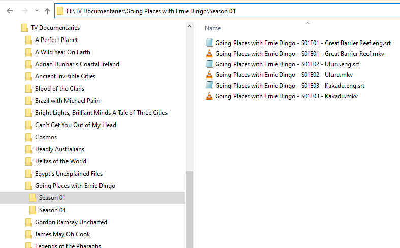

including the file extension - mkv/mp4/etc.
Like our old friend Ernie Dingo says:
(set your file manager to show extensions)

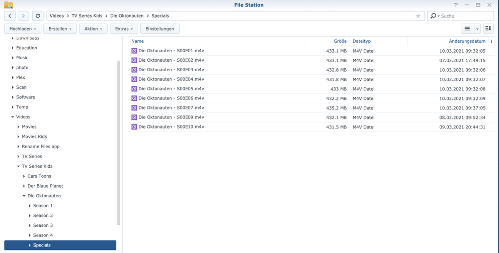

Thanks for your quick reply. Yes, that’s correct: when I click on S00E01, S01E31 is played instead. I do not use any playlists or playqueues. The NAS is a Synology 918+ (DSM 6.2.3-25426 Update 3).

OK, I didn’t know that and I am puzzled as I created the folders my myself and have been using PLEX on this NAS and its predecessors for years without any issues so far. However, good to know thank you. I doubt that this is the culprit though. I removed the 2 episodes from plex (with the whole PLEX dance) and placed the two episodes on another share. I then created a new series library with that folder. It is the exact same behaviour: when clicking on S00E01 episode S01E31 will be played instead.
Please let me know if you need some more screenshots or any other information.
