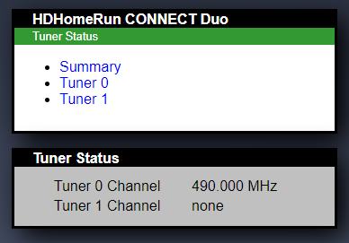

Hi. The recordings fail while I’m watching Live TV on Plex and the first tuner is in use.
This is what the tuners status is. Even though Tuner 1 is free, Plex won’t try and use it for whatever reason and the recording will fail.
Plex does not request a specific tuner, ie tuner 0, but makes a request to the tuner device. The device determines what tuner will be used or sends a rejection message to Plex if it is unable to fulfill the request. Would need to check the Plex Media Server log immediately after a failed recording to see why the recording failed.
