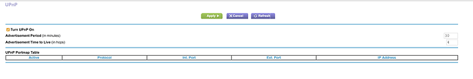

I have Plex server set up on my Synology NAS. I have forwarded the ports on my router, maybe more ports than needed. I have shut off anti-virus as well as firewall on the NAS yet I cannot access Plex outside the network. I did a port check for 32400 but that returns a problem. Moreover, the port check for NAS DSM like 5000 is also showing an issue. I have UPNP checked too. I am enclosing pics of everything I have done so far. All help to rectify this would be greatly appreciated.![57%20PM|690x218]

When I uncheck ‘Manually specify public port’ Plex uses port 13088. When I try to port forward this port on my Netgear router, I get a message indicating other configurations are using this port. Could the problem lie somewhere here. I am enclosing a pic of the message I get on my router.
I have not used DDNS or QuickConnect for Plex. Also, have been on 32400 for remote access. Also on my Netgear R8000 router I have tried with a single port forward rule that of Plex but its not working that way either. UPnP is enabled too. Logged out of everywhere, stopped the Plex server on NAS and restarted but no avail.
