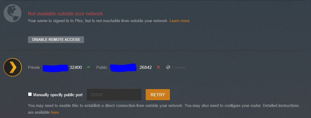

I´m trying to enable remote access for my PLEX server which is on a Synology Diskstation DS916+
This is my setup:
PLEX Server Version#: 1.15.6.1079
ISP modem is in bridge mode (to prevent double NAT) as it is connected to a Asus RT-AC5300
Router has NAT and UPNP enabled.
Firewall is active with DOS protection enabled, disabled ping requests.
Diskstation has a static address in DHCP server.
Portforwarding is enabled for TCP-UDP 32400 to the DS916+
Despite all this, I´m still getting that the server is Not available outside your network.
When I enable remote access it say it is possible for 2-3 seconds then it becomes unavailable
I´ve tested with putting the DS916+ in DMZ on the router, disabling the firewall but nothing changes, I still get the short up connection before it fails.
Any and all assistance is very much appreciated.
Let me know if you need logs and how to gather what you need.
Thanks and best regards.-
If you have port forwarding set up in your router then you need to enter the port you used for the external port in that “Manually Specify public port” field and check the box next to it so the server does not try to use UPnP.
Thanks BigWheel,
I forgot to specify, that when I portforwarded I had the check mark in that field.
Unfortunately it did not change the end result.
Still say server is not reachable.
