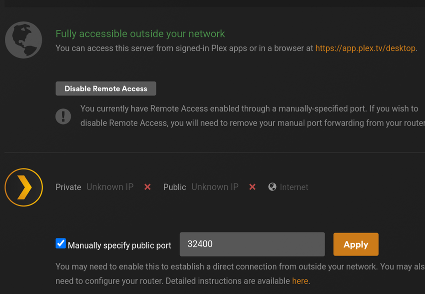

This is what I see now on my Plex server settings > remote access page. It’s now showing remote access is fully available, but I no longer see my local to public IP mapping in the middle section.
When I click Apply for the manual port, it hangs indefinitely and shows “Connecting…”
Turning off NAT reflection on the Opnsense got me past the Plex remote access hanging with “Connecting…” when applying manual port 32400.
With NAT reflection off, Plex remote access settings now shows my private-IP:32400 < public-IP: 32400 correctly, but it bounces between remote access connected to disconnected. It only remains connected fully accessible for 3 seconds.
