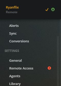

Any update on this? I’m getting the same thing but I THINK everything is working for local and remote. I just don’t know if there’s a quality problem for people using remote.

@ryan810cows , what happens if you effectively click on the Remote Access section ? It stays red ? I’ve seen it quickly change to Green/OK once you effectively go on it.
Mine of always consistent Green/OK WHEN I GO ON IT!. I do have a DNS-records pointing to the public-IP of my entrypoint.

As mentioned above in this topic it sometimes showing red is often just because the interface itself in browser is not updating. if you go to the actual remote access page it will force it to update
When i go to the section it’s still no good according to that page but it still is working remotely.
If i click “retry” it goes GREEN for about 2 seconds and then goes to RED.

WELL… turns out is has to do with pfBlocker!
I thought i had turned this off once to see if that was it.
Guess i didn’t REALLY stop the service!
NOW… i need to find out WHAT is blocking it inside pfBlocker!
