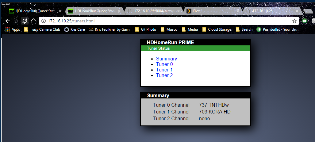

@sa2000 said:
@gadgetgeek2000 I have discussed these with the development team.
Plex Media Server keeps track of number of tuners it uses and by specifying /auto on the request to the tuner - as in http://172.16.10.25:5004/auto/v737?duration=669 - we are asking the device to pick a free tuner - and apparently whenever we have overlapping recordings - meaning we need more than one tuner at the time - the answer has been go away Error 503.
With that URL I looked at the .25 tuner status. 2 channels out of three are currently tuned and streaming:
When I try to kick off the third channel I get:
If I stop the download so that only 1 tuner is in use I can kick off the download again just fine. But I can’t do a third on 172.16.10.25.
As a test, I just kicked off 3 channel streams on 172.16.10.26. It is able to do 3 simultaneously no problem.

FYI, It was very helpful to learn this URL when testing doing my own testing. I can open up VLC, choose Media > Open Network Stream and then paste in the URL. Easy to diagnose once I knew the method.
When diagnosing tuner problems I would suggest taking Plex out of the picture altogether, and have the customer check to make certain they can stream all the expected media simultaneously.
Open VLC, open the network stream. Open another copy of VLC, open the network stream. Repeat once more to make certain that all 3 tuners are functional.
