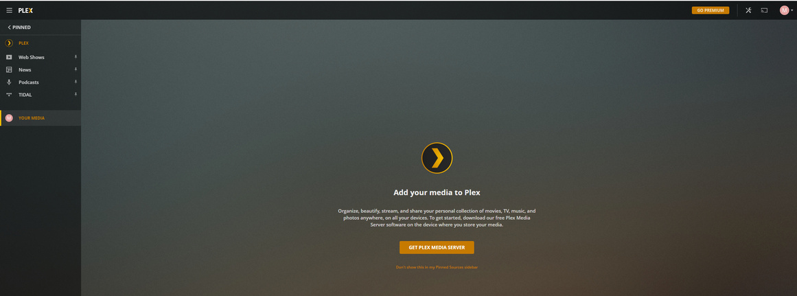

Just want to mention I am only able to do this after a fresh install of plex (uninstall from apps, delete registry keys, app data - C:\Users<username>\AppData\Local and install dir) as my media server no longer is available/doesn’t show up (screenshot below) but I am able to access the server for a few minutes after the first scan.
I did try steps creating a C:\plexdata, reconfiguring the local app data folder, stopped it via the task bar, waited a few seconds then started again. Unfortunately, this did not work as my I am unable to see/access/configure my media server and plex is giving me the “Get Media Server” page:

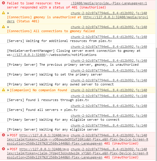

Unfortunately still didn’t work and I have the disappearing server behavior again but one thing that did change was first logon/load of Plex an error quickly flashed up with “Unable to claim server” on the logon page. Subsequent attempts on clicking the Claim Server button on the Sever settings page throws a 401 Unauthorized in the Chrome console (the last two are my button clicks).
chrome errors
