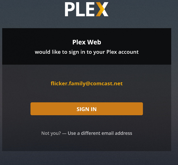

I uninstalled Plex again. Installed it with default installation folder. Clicked launch button. Selected Open Plex got the original screen, clicked got it, named my server, unchecked accessible outside my network box (I got the same result when I had it checked before an uninstall reinstall cycle), I get the attached screen. After a prolonged period of the spinning wheel, I eventually get to an add a library screen, I clicked finish, and after another long delay, I get Flicker-SRV Plex2 not available.
I am attaching the screen shot and log file for this installation. I have uninstalled and reinstalled Plex Media server several times now and cannot get Plex to start up as an unclaimed server and then let me link it to my account. Thank-you for any assistance that you can offer. StuartPlex Media Server.log (585.7 KB)

When I log out of Plex, it immediately takes me to the login screen. If I close that tab and paste in the local web address: http://127.0.0.1:32400/web the page hangs for minutes while it displays waiting for 127.0.0.1. The longest I waited before I closed the tab and tried again was about 10 minutes. I exited Plex, restarted it, then tried the local version of the web app again. It immediately redirected to another url
(https://app.plex.tv/auth/#!?clientID=lbgtbaottt&context[device][product]=Plex%20Web&context[device][version]=3.95.2&context[device][platform]=Firefox&context[device][platformVersion]=67.0&context[device][device]=Windows&context[device][model]=bundled&context[device][screenResolution]=2176x1061%2C2176x1224&context[device][layout]=desktop&forwardUrl=http%3A%2F%2F127.0.0.1%3A32400%2Fweb%2Findex.html%23%3FpinID%3D1594047311&code=s9p0titspvf4xzovyzgg27uqo).
This URL prompted me to login. I closed this tab and tried the local web app again. It again redirected me to the login screen. Thank-you for your assistance. Stuart
What I meant with ‘incognito’ browser window is to open a special web browser window which doesn’t use your regular browser settings and cookies.
With Chrome you use CTRL+Shift+N
with Firefox CTRL+Shift+P
Otto,
Thank-you for your additional instructions. Using a private browsing window from Firefox, I obtain the same result. I get a window asking me to log in using my Plexpass email. I do not use Chrome, but installed it to perform your instructions. Using a private (incognito) window from Chrome I get the same result. A short delay and a request to login to my Plexpass account. Thank-you. Stuart
