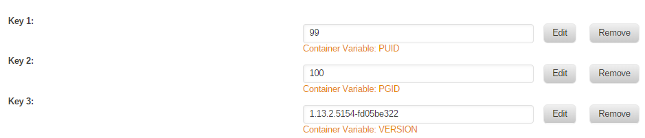

That’s weird. works for me when accessing it on the local network, with the linuxserver.io container.
Remember to update the container with the above version string.
Example:

It loads fine, but it still gives me the timeouts. Even tried it in Bridge:0 mode with a Fixed IP address. As shown here, currently, I’m in Host mode.

@JacobPed SUCCESS!
I had to do it in unRAID as: Repository: “plexinc/pms-docker:1.13.2.5154-fd05be322” then it pulled correctly for me.
It’s been working for about 18 hours, and I can connect to it instantly. It seems to not correctly use the VERSION even though I had it in there as “1.13.2.5154-fd05be322” It’s in both fields and it’s been working and unRAID is also not nagging me to upgrade it either.

I’m on Version 1.13.8.5395, both the linuxserver.io docker image and the plex docker both pull this version down automatically :frowning: EDIT: looks like I can specify 1.13.2.5154 in my compose file so it only grabs that version.
Specifying 1.13.2.5154-fd05be322 in my compose file and redeploying makes everything good in the world again.
