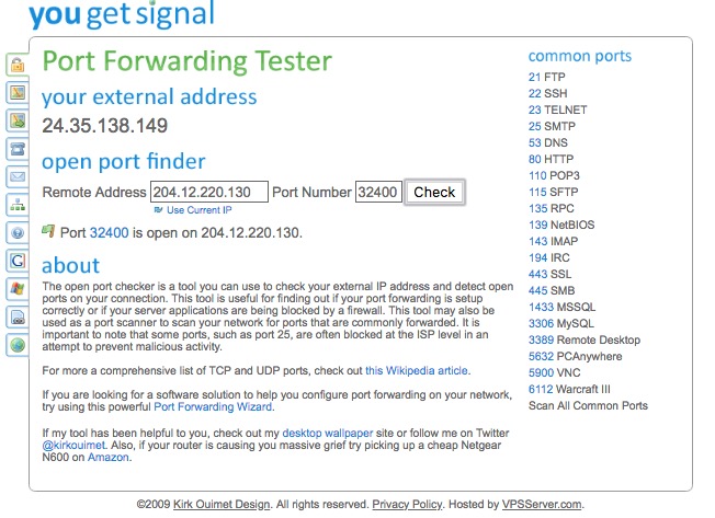

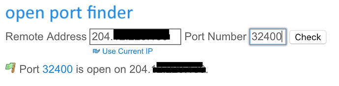

Have you checked to see if the port 32400 or the port-forwarded port is open on that machine from an external source?
Yes …
09%20PM
