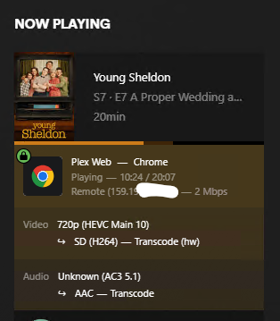

Recently my plex server has started advising that it’s remote access is not available. I “retry” and it goes green, then after about 30 seconds it goes red again.
But it seems to be working. And not “indirectly” that I can tell. This from the dashboard
plex2
So I don’t understand why it keeps disconnecting. Or appearing to. And still working. I’ve gone through the remote access troubleshooting but none of that seems to apply here. That I can tell anyway.
