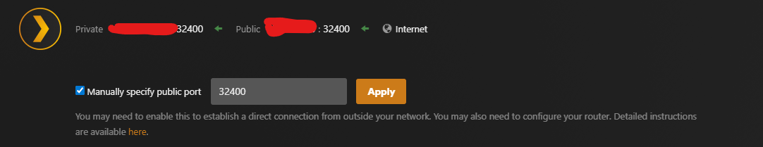

I would really like for plex server to work continuously without any intervention every once a while. Newest problem I got is plex not available remotely. Everything was correctly configured, port opened on router, remote access enabled on the plex server etc.. but suddenly it stopped working.
After clicking on button Retry i get this:
the green arrow is fake, it still doesn’t work, after new login red arrow gets back and the remote access still doesn’t work. Disable / enable remote access gets the same behaviour.
Tried turn off “Manually specify port” - no luck - connecting to server forever
UpNP is on, aditional port 29716 is redirected to 32400; I can open and play normally outside network from http://myCurrentIP:32400/ and http://myCurrentIP:29716/, but form mobile, app, TV app and https://app.plex.tv/ reporting server offline.
What is the problem?
