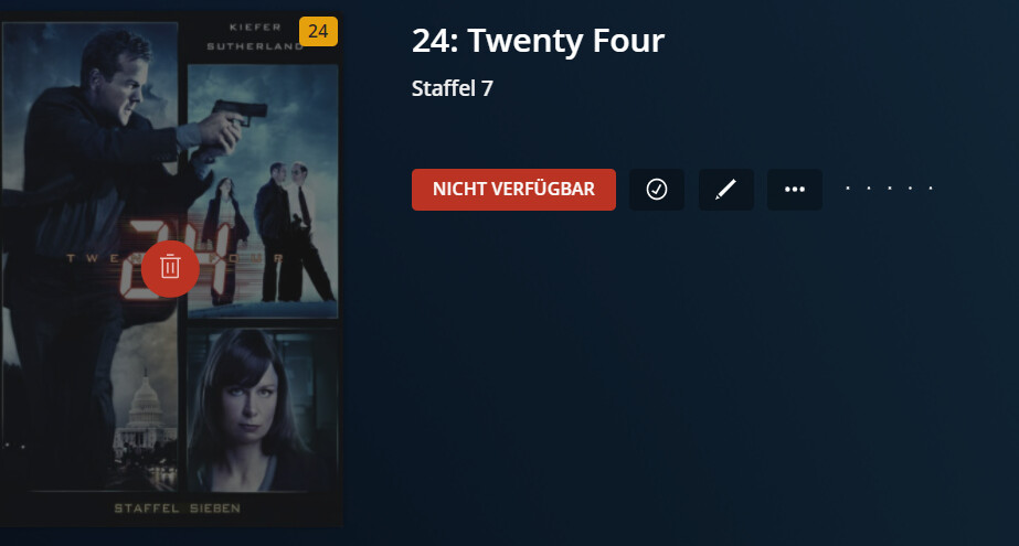

plex is showing me that one season of the TV show is unavailable:
what’s the issue here? I did a rescan, nothing changed. The episodes are available and I can play them.

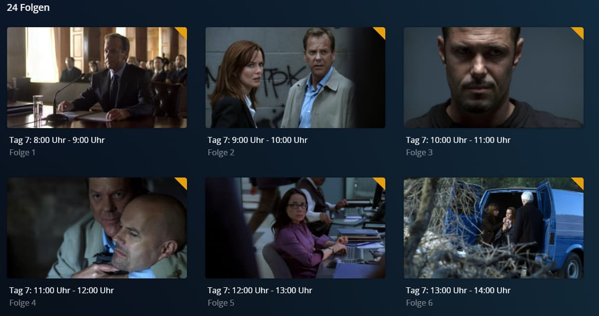

Enter the season and inspect the pictures of the episodes. One or several might have the trash bin icon as well.
Inspect the Plex media info of these episodes. You might find that the affected episodes have actually not one but two or more files assigned – of which one might be unavailable.

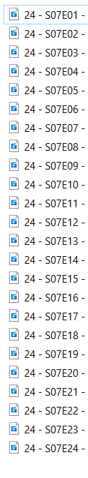

There is no Icon around and I checked the season folder… there are 24 files nothing more (no doubles)

There are no “duplicate” indicators anymore in the UI.

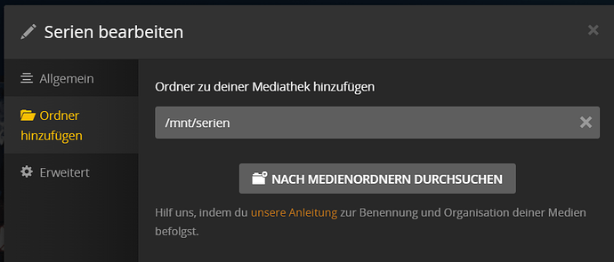

Edit the library, go to the “Add Folders” tab, and check all paths listed in there if there any one is either completely empty, invalid or inaccessible.
Ich checked every single episode and checked for duplicates as you mentioned. No duplicates around or files that are missing.
I only have one folder for this library.
