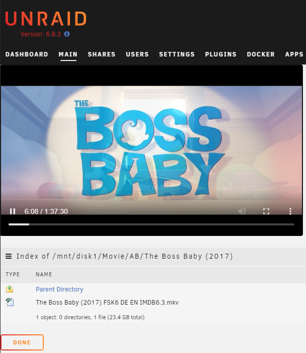

Same problem with 1.20.3.3437 even with ram cached movies on my server. So this can’t be a latency problem. It must be only related to the way how Plex plays the movie.
I was able to play the movie without judder with an usual HTML5 player by pasting this code into my Unraid WebGUI source code (chrome dev tools):
<video id="video1" style="width:600px;max-width:100%;" controls="">
    <source src="http://thoth/mnt/disk1/Movie/AB/The%20Boss%20Baby%20(2017)/The%20Boss%20Baby%20(2017)%20FSK6%20DE%20EN%20IMDB6.3.mkv" type="video/mp4">
</video>
But it had not audio (I guess, the codec is not supported by HTML5):
2020-10-19 13_32_09
Maybe this is the point (video stream + audio stream syncing) which causes these gap jumps.
