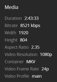

Understood, but does this constitute high bit rate?

As the previous user said if it was as simple as that and always been that way, why does it work fine for all of us when we roll back to version 1.24.x?
This is a reliably reproduceable issue on v1.25.x. I personally have had no issues with firefox and original quality, until v1.25 came out.
