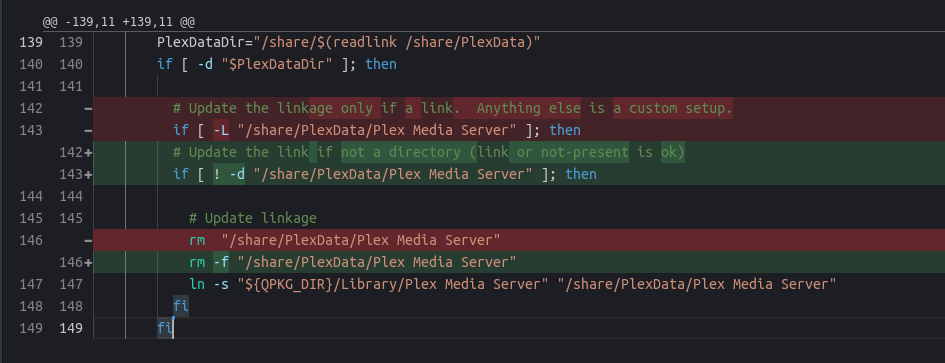

I must apologise.
I understand why you’re frustrated now.
The PlexData share was working properly.
QNAP made a change.
The PlexData share linkage broke.
It got caught in a race condition and cannot create the link.
I fixed it but the QNAP package hasn’t been updated by Engineering yet.
The changes to make to plex.sh
( /share/CACHEDEV*/.qpkg/PlexMediaServer/plex.sh ) are here:
Red = Deleted
Green = Added
Line 143: Change - L to ! -d (look for a directory and not a symlink)
Line 146: Add -f to the rm command.
I’m sorry for this manual edit.
Once PMS starts and creates the link, even with the broken package, everything will work.
The updated package, when they release it, will be correct.
This will have no impact on your PMS itself.
This only addresses the PlexData/Plex Media Server link.
It will restore the ability to manually get the log files in FileStation.

126       # Remove GPU temp file.
127       rm -f $TEMPFILE
128
129     fi
130
131     # Is the PlexData feature (NOT) disabled?
132     if [ ! -e "${QPKG_DIR}/Library/Plex Media Server/.disablePlexDataSymlink" ]; then
133
134       # If a shared folder, named PlexData, exists,  create a link there
135       # Otherwise, do nothing
136       if [ -e "/share/PlexData" ]; then
137
138         # And there's a real directory backing it
139         PlexDataDir="/share/$(readlink /share/PlexData)"
140         if [ -d "$PlexDataDir" ]; then
141
142           # Update the linkage only if a link.  Anything else is a custom setup.
143           if [ ! -d "/share/PlexData/Plex Media Server" ]; then
144
145             # Update linkage
146             rm -f "/share/PlexData/Plex Media Server"
147             ln -s "${QPKG_DIR}/Library/Plex Media Server" "/share/PlexData/Plex Media Server"
148           fi
149         fi
150       fi
151     fi
152
153     logMsg="Starting Plex Media Server..."
154     echo $logMsg
155     /sbin/log_tool -t 0 -a "$logMsg"
156
157     export PLEX_MEDIA_SERVER_MAX_PLUGIN_PROCS=6
158     export LC_ALL=en_US.UTF-8
159     export LANG=en_US.UTF-8
160     export LANGUAGE=en_US.UTF-8
161     export PLEX_MEDIA_SERVER_APPLICATION_SUPPORT_DIR="${QPKG_DIR}/Library"
162     export TMPDIR="${QPKG_DIR}/Library/tmp"
163     export PLEX_MEDIA_SERVER_DEFAULT_PREFERENCES="HardwareAcceleratedCodecs=true&TranscoderCanOnlyRemuxVideo=false"
164
165     # Set identification variables
166     export PLEX_MEDIA_SERVER_INFO_VENDOR=QNAP
167     export PLEX_MEDIA_SERVER_INFO_DEVICE="$(getsysinfo model)"
168     export PLEX_MEDIA_SERVER_INFO_MODEL="$(uname -m)"
169     export PLEX_MEDIA_SERVER_INFO_PLATFORM_VERSION="QTS $(getcfg system version).$(getcfg system Number)"
plex-sh.zip (2.8 KB)
Be so advised. plex.sh doesn’t have ANY impact on the internals of Plex itself.

Let me get someone to assist.
As Arnold S ones said, “I’m back”
@RoSe83
Download this: https://github.com/ukdtom/PMSLibShare/releases/download/1.0/PMSLibShare_1.0.qpkg
Install from the AppCenter, and you should have a share in your filestation named Plex
Please confirm after that.
