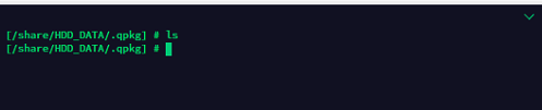

Also on further investigation: The location below doesn’t exist on the NAS at all. So is there a way to modify where it points too?
/share/HDD_DATA/.qpkg/PlexMediaServer/Library/Plex Media Server/Cache
