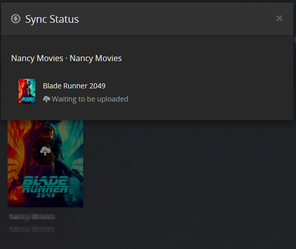

Here is what I see. I have one Cloud sync, with only one movie. It has been stuck in the status for over 24 hours.
