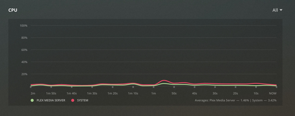

When I’m syncing content that needs to be converted to my iPad it seems like the conversion is SUPER slow. Checking the dashboard, its hardly even using my CPU. It makes sense that these are considered a lower priority, but for a 45m TV show its taking hours to convert (1080p). I don’t think this is a power issue, its a Plex isn’t hardly using my CPU power to convert sync. Is this expected? This makes syncing 10 tv shows take over 24 hours, which is pretty much useless for me at that point.

This is what CPU looks like with an active sync conversion
Thanks for the logs. I found it immediately.
The Intel iHD driver is failing for your CPU.
The team is working on fixing the Intel-provided driver but it’s not done yet.
